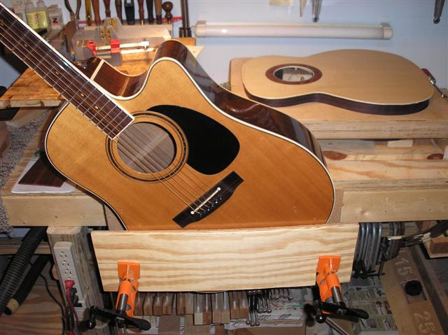

There was an article that spanned about 3 issues in the GAL magazine* on jigs and fixtures than none other than “Mr. fixture” himself Charles Fox. It has loads of great stuff in there and I am pretty sure that is what inspired my take on the guitar holding vice. I think he used Veneer Press screws, to apply clamping force but I had the pipe clamps hanging around, so I used those. Hopefully from the 2 pictures it should be fairly self evident.
In this shot I just did a coat of pore filler the guitar and needs a little cleanup before I do the second coat. I have some fairly rigid “foam” in vice that grabs the guitar pretty well and makes-up for discrepancies in the radius of the MDF clamping face. Carpet would probably work too.
Here is shot looking up from the bottom. You can see my sling. This prevents the guitar from falling on the floor, should I open the clamps without a good hold on the guitar. It has save me from a repair more than once. (I think that suggestion also came from the GAL article.)

John, you've probably used your vise for a long time without incident, but those building one for the first time, I'd suggest some foam pipe insulation on the pipes between the jaws. That way you won't scratch or dent your guitar when it inevitably bumps a pipe. The foam is cheap and readily available in the plumbing section of your local hardware/home center.
PostPosted: Mon Jun 12, 2006 12:24 pm
Joined: Tue Jan 11, 2005 12:01 am
Posts: 234
Carlton
Yea I saw that foam in one of the photos above. That is a good idea. I am sure I got something around here, or I will pickup some of that insulation at the home center... An ounce of prevention.
